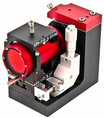

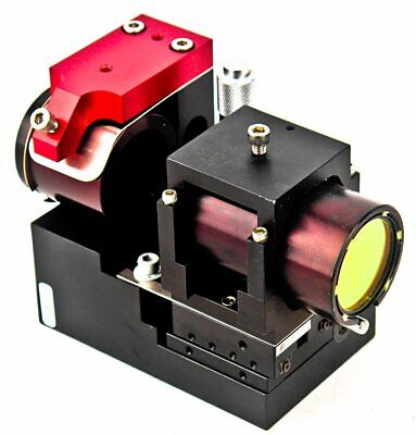

There is a response to my PL post: BUYING lyot filter/birefringence tuner (photonlexicon.com)
Might have to rethink using a birefringence filter. They are not cheap. Also not sure if I could go down the ITAR route.
Yes, ITAR is a problem
Yes, I am not sure if I would be allowed to utilise a US controlled optic. I’m an ally to the US, and not utilising it in a Chinese/Russian project. But a bit silly now that birefringence optics are available to them.
See last couple of posts: BUYING lyot filter/birefringence tuner (photonlexicon.com)
Wow, what an impressive looking system that is from. I presume it will be transmissive, but if you can find out for sure it will be excellent. My concern is the cost and the legality.
Yes, if ITAR I need to research to see if it is still currently restricted and if the UK is part of that restriction. May be moot anyway, his price might scare me.
Use this as a guide Chris.
https://www.newlightphotonics.com/Birefringent-Filter-Plates
1" $269
Obviously these are single plates and will not be the same as what he has. I assume his will be multistack off plates.
